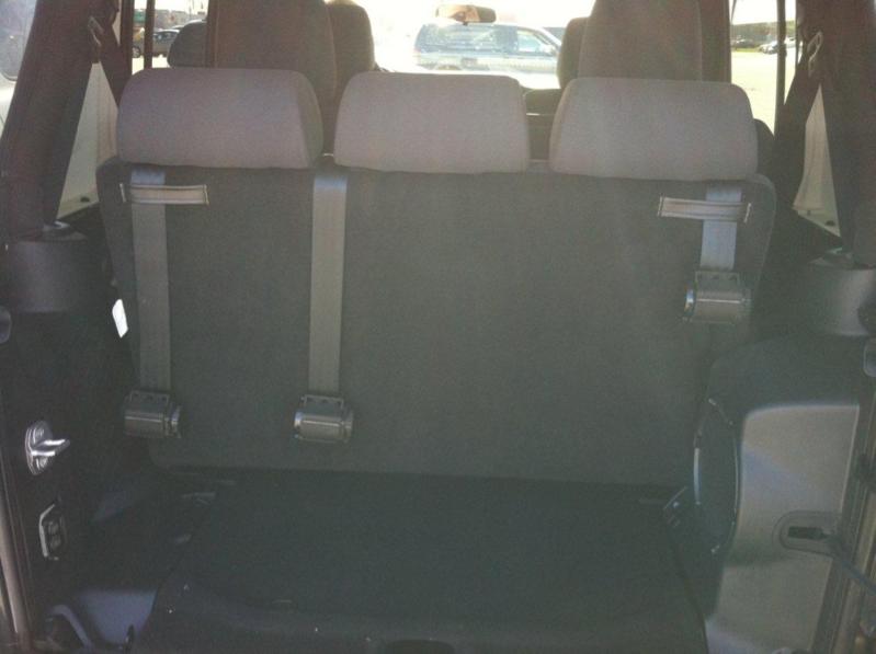

I just contacted little seats the other day about a third row seat for my 12' that I have ordered. This response is posted below. Anyone here have an 11' or 12' with one installed?
Thank you for your interest in little passenger seats. We do make seats for the 2011 wrangler with the subwoofer. I have attached the installation instructions for you to take a look at do you can see what is involved. Please read the following before reading our instructions.
The 2011+ Jeep Wrangler features an all-new interior with improved ergonomics and upgraded materials including a redesigned instrument panel and new storage areas. A new lockable console is added and the center stack is redesigned.
Because of this all-new interior design little passenger seats has not yet had the opportunity to perform an installation. The subwoofer is now molded to the roll bar which makes it difficult to relocate as guided to do in our 07-10 Wrangler Installation Instructions for those with subwoofers. Until we are able to do an install at our facility we are solely depending on the mechanics of our customers. Please read over the instructions thoroughly before beginning this installation.
Below are some notes sent to us by a customer who bought a little passenger seat for his 2011 Jeep Wrangler Unlimited.
So here is what I did:
I mounted the floor bracket the same as instructed. I drilled a new hole in front of the predrilled holes on the bottom mounting plate to match the pre-slotted hole in the seat mounting bracket.
Now if you wanted the seat to reverse position, you would have to put another hole in the seat bracket at the back.
On the back side of the seat, I had to raise the right rear belt 10 inches to clear the sub box. We used a 1/4 plate 10 x 1" and drilled a hole at one end, and a threaded hole at the other to bolt the belt to.
Mounted this way, we can get access to the back floor panel and jack. We did not do any cutting or modes to the jeep and nothing was move to make the seat fit.
It sits in the center really nicely.
Thank you
We welcome any comments or suggestions along with pictures that you may have and are willing to share with us so that we can improve this process. Thank you for your understanding.
Now you can see attached instructions and take a look at those, along with a photo that the customer (above) sent us.
Sincerely,
Samantha
little passenger seats, inc.
Family to Family business since 1991.
800.252.9989 9am to 5pm PT, M-F
209.526.6445 Fax

Old Aug 25, 2011 | 04:29 AM
  #67
newrm76's Avatar
Posts: 108
From: Boston MA
Wow looks great...I wish I could do this...

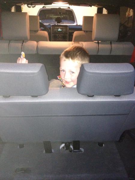

Just had seat installed at Auto Enhancements in Omaha.
ID:	234805   Click image for larger version
Old Nov 10, 2011 | 03:34 AM
  #70
Jsboening's Avatar
Posts: 200
From: Rockford, MI
What vehicle is that seat from? Does it fold down? Looks good!
