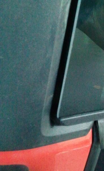

The only thing I had a problem with was that the back seal hit the hard plastic piece of the hardtop rear window, causing it to not shut properly. I had to remove the seal and when I felt around underneath, the plastic piece barely clears the edge of the lid. There is zero room for a seal with the 2011 hardtop on so I will leave it off until I get a soft top.
Here is the window edges with the seal installed and me pushing it in as far as it will go: (the tailgate won't close with the seal in)

I installed mine and initially had a similar problem. What I found is that you have to adjust the front of the enclosure up forcing the back side by the rear window down. This way the seal sits below the window seal and allows the gate to close properly.
