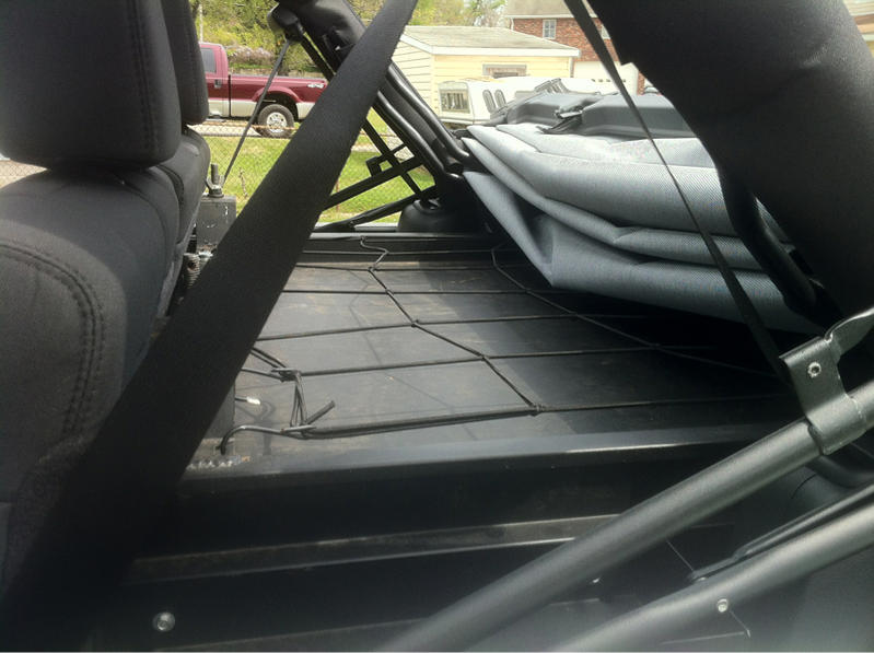

Finally did this today. It turned out great. Agree on needing some extra bolt down points. Thank again for the idea. Not the best pic, but the weather was too nice to leave the top up today.
Some additional pics after the install.
