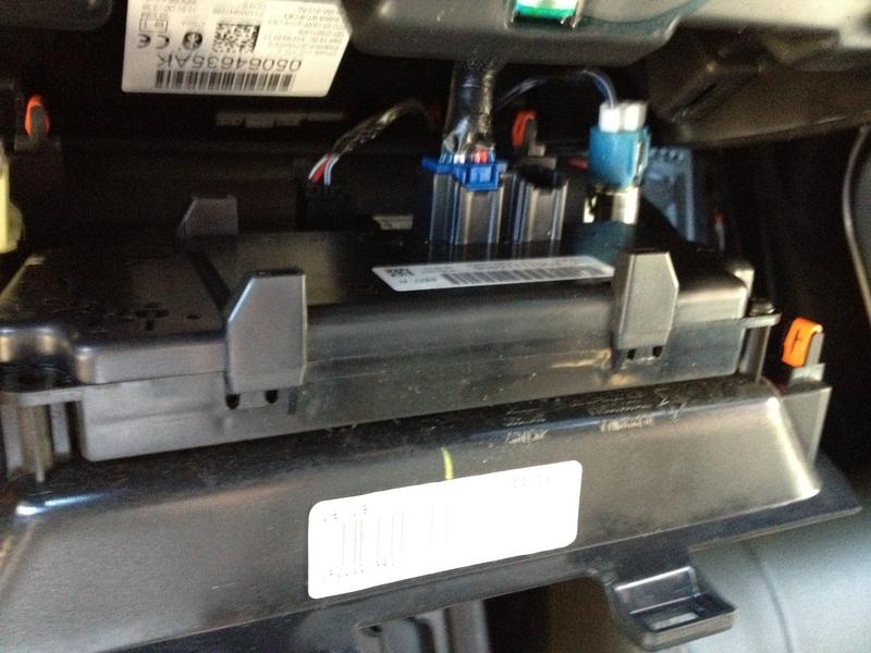

http://youtu.be/CYcZ3iKaA04 I removed the Panel with the AC controls on it. It pops right off. I removed the plug from the back of the control unit.
There are 4 Phillips screws holding the control unit to the panel. I used a stubby screwdriver to remove them so I didn't have to disconnect the other electrics from the panel.

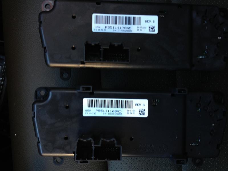

The replacement control unit's rear panel looks exactly like the other one. Plugs look exactly the same.
