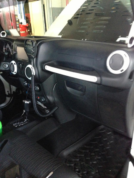

Just installed my warm vr8000 but didn't like the look of the box above the winch or or possibly being submerged.
Tools: 4 gauge flexible automotive wire and (6) 4 gauge wire 5/16 connectors.
Install took about 2-3 hours
Got help from an amp thread by JKU MIKE with running the wires through the fire wall.
Didn't go too picture heavy with details but I replaced all the warn wiring with new wires with the 5/15 connector ends (same size as the warn ends) from the box to the winch. Just make sure your mark the wire and do one at a time.
