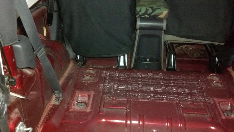

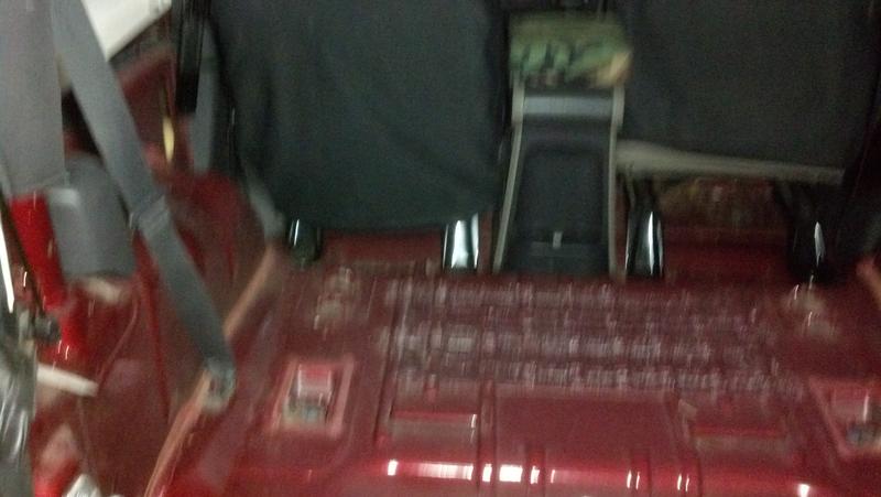

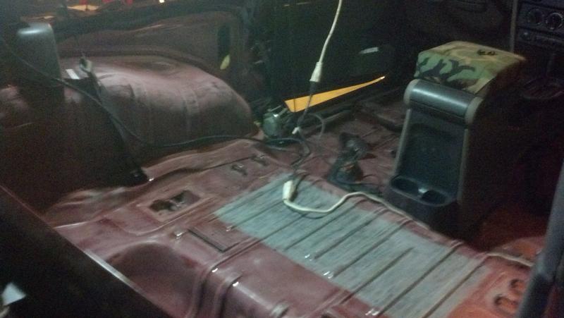

Hey y'all! Just joined the site and I'm thoroughly impressed. Plenty of good gouge on Jeep stuff. Motivated by some of the write-ups, I decided to not have Line-x spray my tub. Instead, I am in the process of doing a Herculiner install by myself.
Here are some of the photos:
Attachment 533958Attachment 533959Attachment 533960Attachment 533961Attachment 533962
Lessons learned:
Seat bolts require heat and leverage...lots of leverage!
Shift knob has a screw under the sleeve
4WD shifter does not! Also, DO NOT TWIST! It doesn't help...much.
Heat protective stuff on the deck comes up nicely with heat gun and a chisel (carefully)
Still can't figure out the Center Console removal. Probably just work around it.
What's the deal with the holes behind the B-Post?? What do I do with them??
I think that's all I can come up with for the evening. I'll update as I go.
Oh yeah...First time topless!

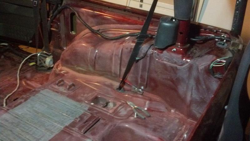

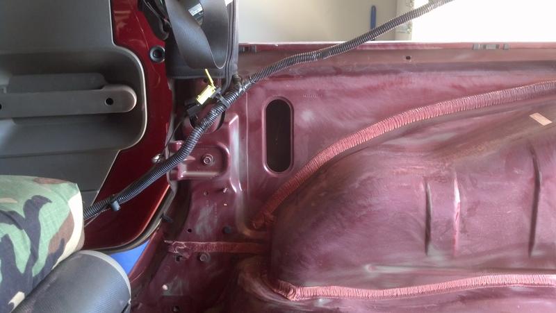

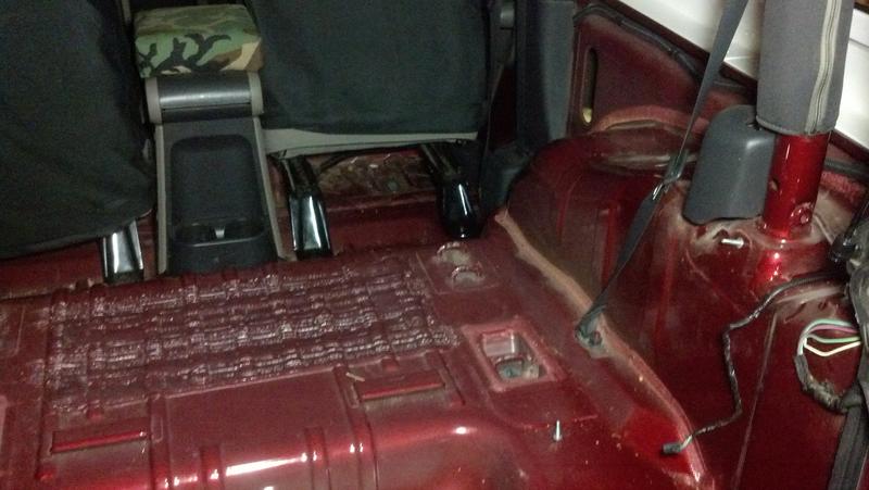

Here are a few more prep pics:

Thanks for the opinion. I don't have an air compressor/spray gun setup. This will have to work. Any suggestions about the B-Post holes?

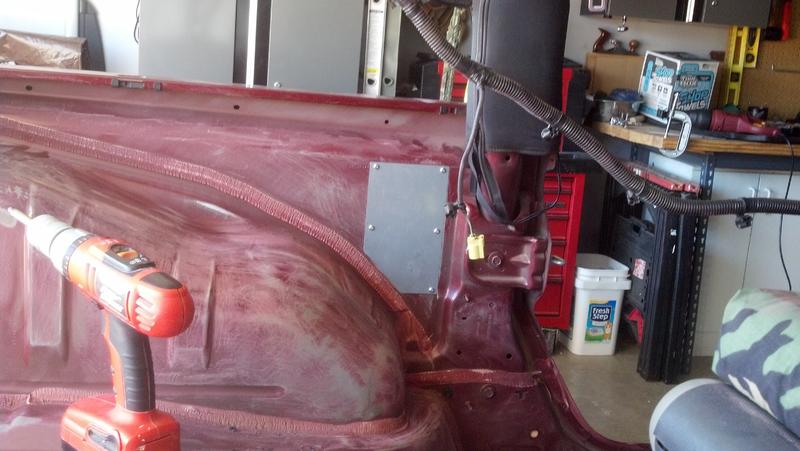

So here's my solution to the B- Piller hole question:

I found a "boca plate" in the electrical aisle at Lowes. Cut it down to fit and attached with self-tapping screws. I figure once the liner is applied, it should look pretty good. I didn't seal it on with an adhesive in the off chance I might need to get access to it. Cutting away Herculiner and undoing some screws should be a lot easier than fighting with the adhesive as well... Just a thought.

Here is the plate with one coat.
