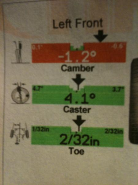

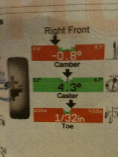

Results from today's alignment
ID:	133369   Click image for larger version
Is that good?

Originally Posted by jwhitehorn
Is that good?
the caster is now since we installed the adj. control arms
it was -2.5 passenger and -2.3 driver
the -.8 camber isnt all that bad...but -1.2...just seems a little off?!
it was worse than that last time, still working on a solution
We could adjust your left front control arms more...

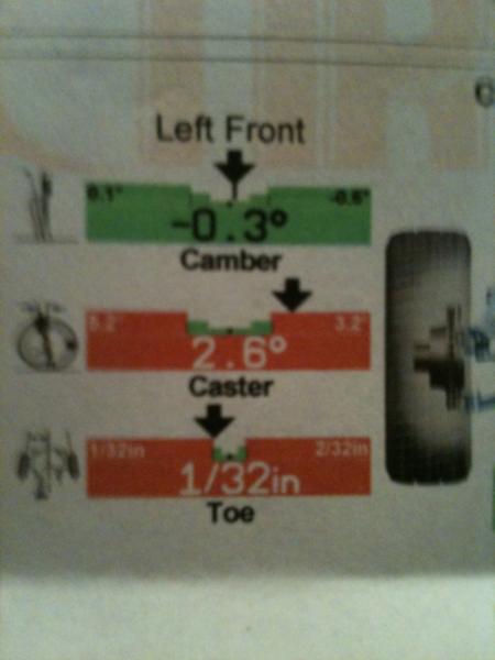

Before adj. control arms (left 2 pics)
After Adj. control arms ( right 2 pics )
i don't know why it would lean that much to be honest ?
