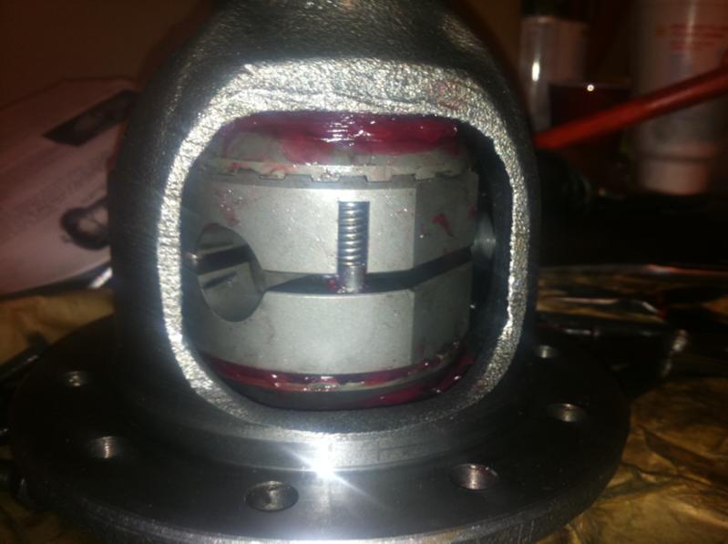

Originally Posted by Hulk
Lube it up quick!!
Ohhh.... If you only knew that the Aussie instruction call for you to use bearing grease as a "glue" to hold it together during assembly
I just got the Aussie back together, and she is now within spec. I got the cam spacing to come out to 0.165 in... Not bad. The spec says 0.145 to 0.170 is good. It previously was 0.128 In. Or something like that.
Now I just need to put the ring gear back on the carrier, and put the carrier back in the Jeep... And put the axles back in, and.... Well... A lot
