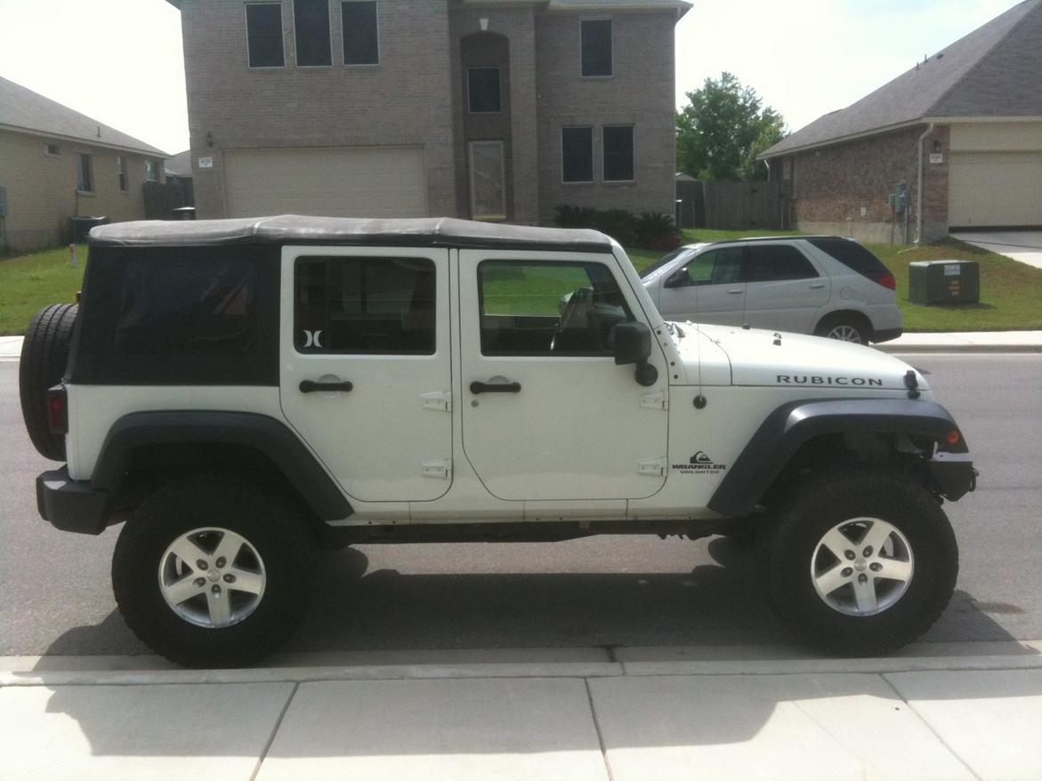

I did mine on a budget for sure. I just got mine onto 37's and have had no issues yet. I went with the Rock Krawler 3.5 entry level with procomp shocks. Right around $700. Found some used 37's for cheap on craigslist to test out how they ride and love em. This lift actually gave me 4.5". They say it's supposed to settle a bit but it's been over a year now and still have 4.5". I had to trim the Rubi rock rails and the rear pinch seam. I also have a stubby front bumper so that took care of any possible rubbing up front. I'm also on 1.5" spidertrax spacers. I thought for sure I'd rub a little while flexing it out but I've had it out wheeling a few times with still no rubbing yet so hope this helps. I'm sure there is plenty more I should be adding/replacing but all in good time I suppose.
