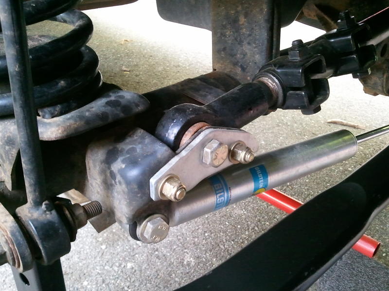

I had a death wobble episode a few years ago and here is what I did. I drilled out the TF Monster bar to 9/16ths. Very easy to do.
Then i put on a Poly Performance brace on the frame side. Very good product. On the axle side, i installed these little brackets from Tera Flex. Worked great and I still have a very tight setup a few years latter.

Thanks for all the great info guys, I really appreciate it... I made some brackets out of some stock I had at work very similar to the TF bracket shown by F200... Worked very well, rig is solid with no DW now... Thanks again...
