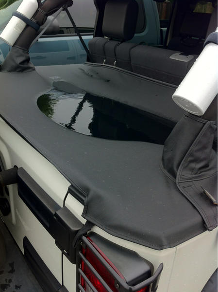

So a couple of years ago I purchased the Bestop bikini top and the Bestop duster deck cover. Everything has been awesome for the most part but I have a problem with the deck cover and I'm wondering if anyone has found a solution. When it rains everything stays dry having the covers on... My problem is that the rain pools up on the deck cover. Not just a little, a good 4" will be on there! It's raining right now so ill snap a pic when I get outta work.

Here it is... Just as I expected.

So it worked as expected !
Sent from my i5 using Tapatalk
Old Aug 15, 2013 | 11:16 AM
BrowHeezy's Avatar
Posts: 107
From: Ladson, South Carolina
Water pooled as expected.

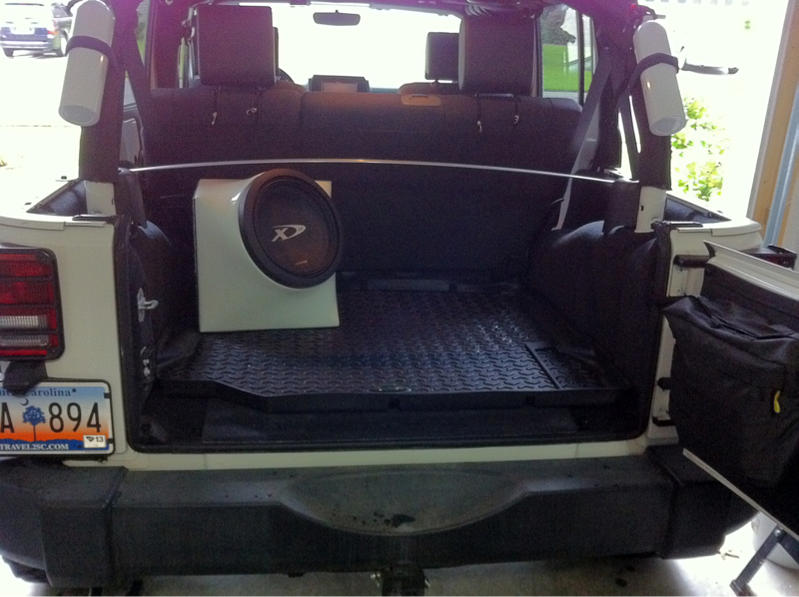

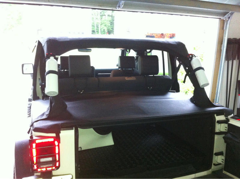

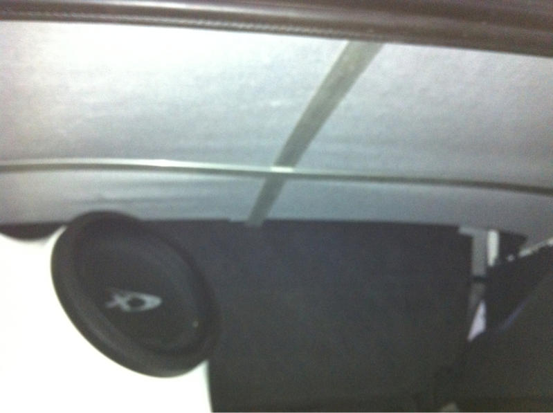

PROBLEM SOLVED! Stopped by ACE Hardware and got an 8' x 2" piece of aluminum. I cut it to a length that would give me a little arch and drilled a hole on each side. Screwed it in using the screws/location of the bolts that hold down the hard top.
