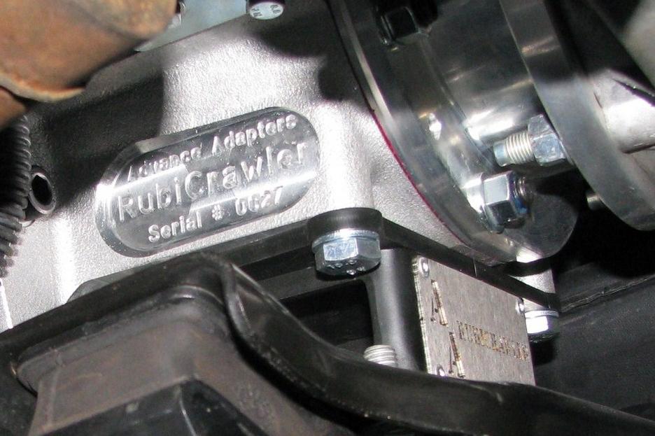

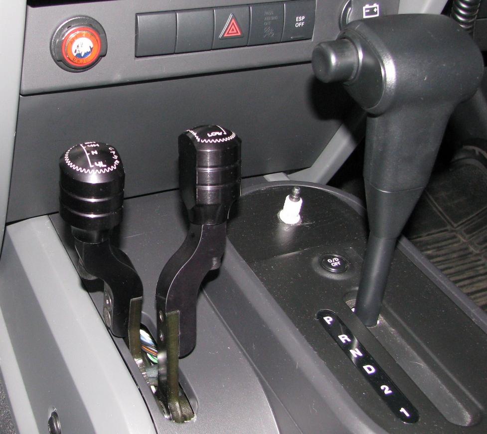

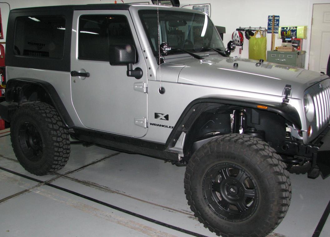

Just recently installed a Rubicrawler into my 07 JK X. The 7.40:1 low range will be nice for trails like Red Cone in Colorado. With the dual shift set up I am able to run an additioal low rage is 2 hi, 4 hi and 4 lo. The install took about 8 hours total with hand tools, no compressor. The only struggle was pulling the extended shaft from the tranny with a slide hammer......it was on there. I have attached some pics if you would like to see it.

Very cool! I just have to know, what is the spark plug that you have mounted in the dash above the shifter for?
I was just tinkering in the garage and built a cover for the console compartment and needed a handle...........thanks for the reply
