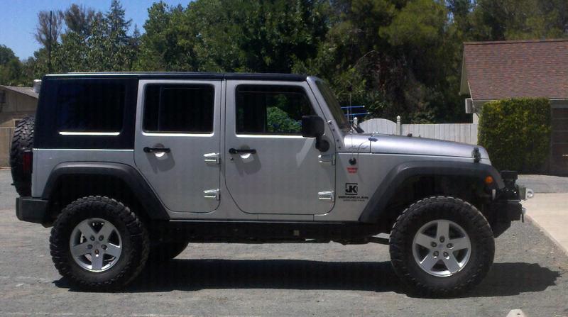

Just put teraflex coil lift on that's it. I have a 08 jku with teraflex coil lift and a 1"spacers all around and front bumper and Warn 10,000 pound winch and i am level. If you go one inch spacers up front you will need a new drive shaft with a automatic. I torn the boot on mine a stick shift not sure.I am now 3.5" of lift. Good luck

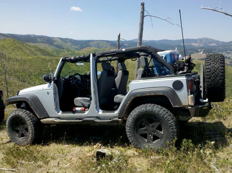

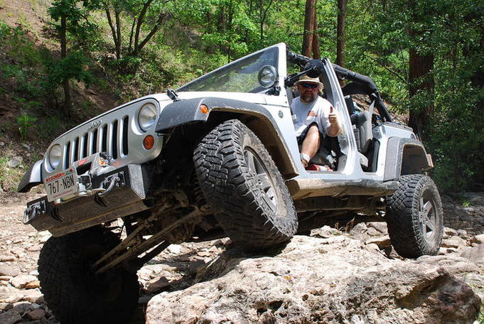

You won't need the spacers unless you prefer it for looks. I have the 2.5" TF kit with springs and shocks. I have a rugged ridge xhd (stubby) up front with a warn 9500lb winch and a smittybilt xrc with tire carrier in the rear. It sits level. I have 1.5" wheel spacers with stock wheels and 315/70R17 Duratrac's. You'll need the spacers to keep a tire of that size from rubbing at full lock.
I did add a jks adjustable front trackback per the suggestion from David at northridge. I also added a 1" body lift because I plan on putting on flat fenders and going to 37's.
One thing I will add is I tear the boot on my front drive shaft just about every time I wheel when I disconnect the front sway bar. Otherwise the setup works great.

It looks like there is a little rake there to me. Maybe not quite as bad as factory though.
If it were me, I would buy the lift without the spacers and then once you get everything installed you can measure to see exactly what size spacer you may/may not need.
