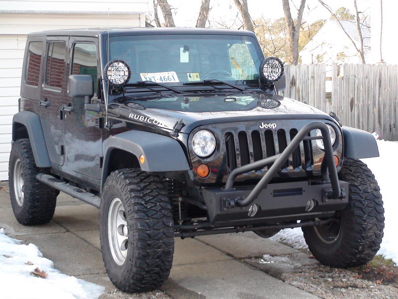

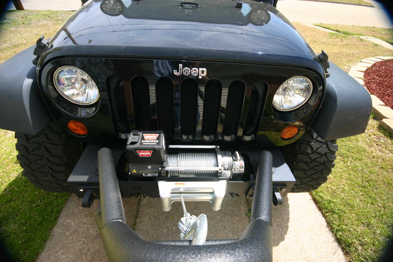

Here are pictures of my 08 . It is a auto and a daily driver . I have a 4.5 bds lift with 315 mickey Thompson,RR XHD front winch bumper with a warm 8000 winch. I love driving it more after it was lifted than when it was stock. . I have 21000 miles on it.
