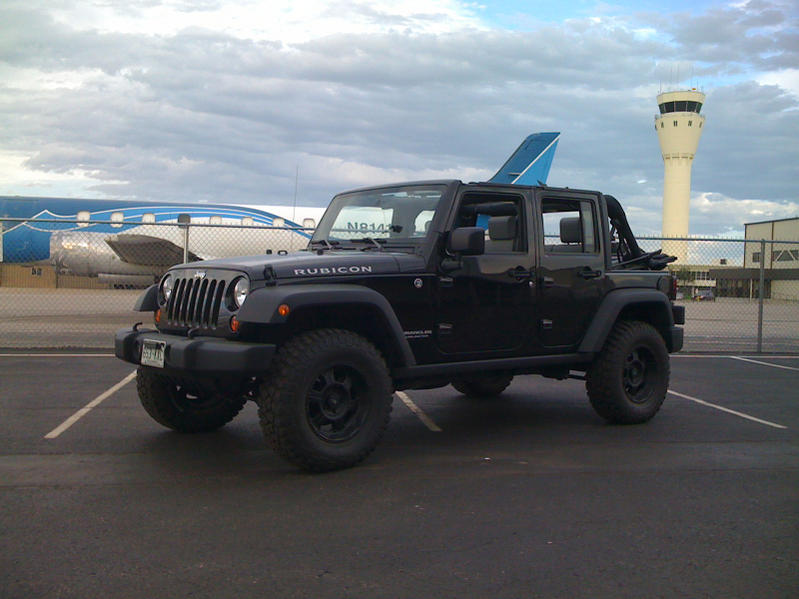

With single spacers up front it won't be that noticeable since your lifting front and back only one inch. I installed two spacers (2") up front.

NCB, your rubi looks great. Just the stance I'm looking for.
That sits great, mind listing your wheel and tire specs?
Thanks
Old Dec 12, 2012 | 11:20 AM
Ncb's Avatar
Ncb
Posts: 1,087
From: Parker, Colorado
Wheels are 17X8 with 4.5" backspacing. Tires are 285/70/17 KM2.
Old Dec 12, 2012 | 11:54 AM
idiotec's Avatar
Posts: 602
From: El Dorado County, CA
Awesome, thanks. ProComp 7089's?
