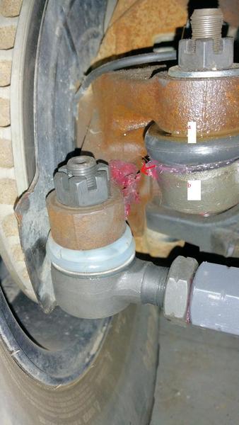

forgive my ignorance, the TRE above the one you're working on. it seems a little full? are they that shape? If "A" and "B" make "contact" will the boot burst? the arrow is pointing to some grease that might of squirted out already? Im really sry to point this out im just wondering for future installs. Again if im wrong my apologies.
Someone can correct me if I'm wrong but I don't think it's a problem. Any excess grease will get squeezed out. And that's the drag link so I don't believe it sees much abuse.
I'm wondering though if I was supposed to install it flipped on top. I'm not able to install my new steering stabilizer because the drag link interferes with both mounting holes.
