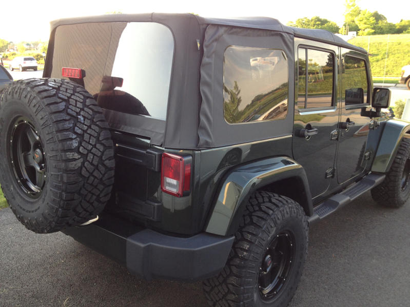

This was 1.5" spacers with 3.5" backspaced 15x10's with corresponding 10.5" wide tires. It sat exactly 84" wide at the widest point and I could still drive it and park it without any issues. The lack of rear bumper exaggerates it but with everything back in place and looking at the jeep on the whole, it looks right.

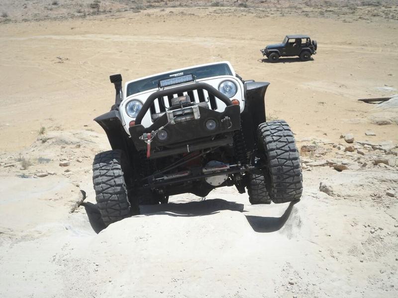

This is my rig with 315/70r16 with 4.5 backspaced wheels. Hard to tell from the pics but the tires stick out past the flares by about 2.5".
