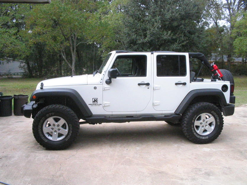

RE 2in bb, 1in more bl w/ 35's back in the day
As stated before, the steps move up with the body, you only get a gap in front and rear. Rear easily fixed( not in that pic though) front you really don't notice.
Attachment 33278
Awesome.... thanks mkjeep. How is the ride quality with the BL? Looks great with 35's as I may be going up to 35's when my STT's wear out.....they still look new after 2 years...
