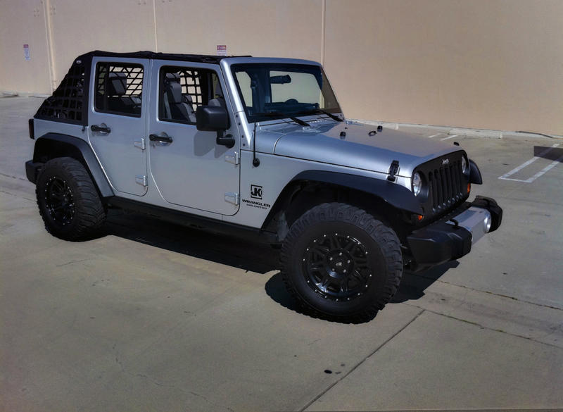

I bought the 1" front spacer for my 4 door since the rake is noticable.
Now i'm second thinking this , if i should put those on or not... will it make a huge differance in the ride , steering and so on...?
Also, once i had second thoughts i look at my jeep and looked fine to me lol
i need help , opinions and maybe pictures of some who have done this move .
Please...
Thanks in advance
Here are some pics to help:

Puck it!!!! Actually it looks hot. Just wanted to say it.. I like your ride and IMO I like a level stance. When I leveled mine my hood started to dance around more. Its your opinion and only 2 hours or less of work to add or remove. The puck wont change your handling or anything at only 1 inch..

I think putting a 1" spacer in there might be a little much. A 1/2" would probably do the trick for you, especially with a stock stubby bumper.

Thank you so much for the help.. i'm just confused becasue before i put the tires on it looked really bad... noticable but now its not as bad. maybe becasue the rear tires are completely worn and the fronts are still good.
i have a freind that is letting me use his lift tomorrow if i want, thats why i am going back and forth on this... i dont want to have the front higher than the back after and have to do it all over again without a lift...

A little more info. The Teraflex coils lifts are designed to lift the front end a 1/2" higher than the rear. That's exactly what I got when I installed mine, 3" in the front and 2 1/2" in the rear. I put a level on my Rubi rail and it was dead balls level. I have since put on a steel bumper and winch, so now I'm nose down again. I'm planning on adding a 1/2" spacer when I get my LCA's, because I'm not a big fan of that nosedive look either. I know you don't have a lift, but my point is that a 1/2" will do the trick with your stock bumper.

You can see it more in the stock pictures... i am planning on getting a winch and maybe mounting it on the stock bumper... possibly.
Winch would be my first real mod though since mine is a 2WD. 4x4 conversion in planned for the next 6 month. but for now i do take it offroading and scared i will get stuck ( i think i winch will give me a peace of mind)
Anyways , back to the subject.. if i get a winch i would most likely need to bump the front more... i just hate to have to change it and i am worries it will look funny for now with the 1" in the front... oh dilemmas....
