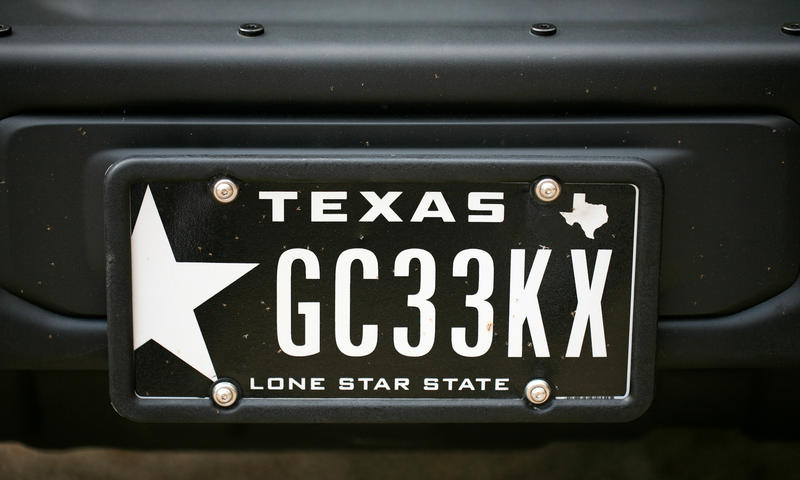

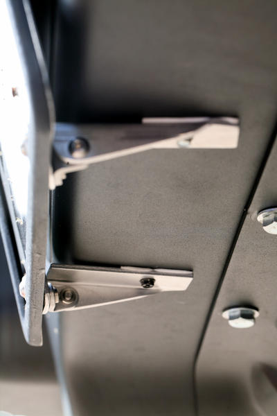

Default Skene Design front license bracket on 10A bumper pics
Originally Posted by chad s
That was my next ? The front plate. I live in Maryland and a front plate is required thanks for the info. So did u have to drill to install plate bracket? Can u post some pics when u get a chance. Thank you
Per your request:
Front view:

Top view:

(I replaced the provided Phillips-head mounting screws with hex-head screws for more torque when screwing into the steel bumper. Of the two I had on hand in the right size, one was silver and one was black, but you have to get under the bumper to even see them.)

Note that the position of the plate is adjustable vertically ~ 4 inches. I have mine installed in the highest position.
Once I finish my home remodel project, I plan to paint the bracket and its hardware black (as well as the bolts & washers holding the skid plate in place), using rattle can bedliner spray.
