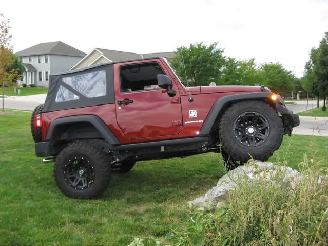

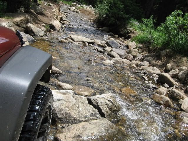

These are the only 2 pics of mine that I could find with the 33x11.5 tire on a 17x9" wheel.
As you can see, there's certainly not much tire out to the side, but it looks fine.

Thanks zoeydad for the pics!!!!
