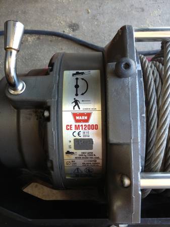

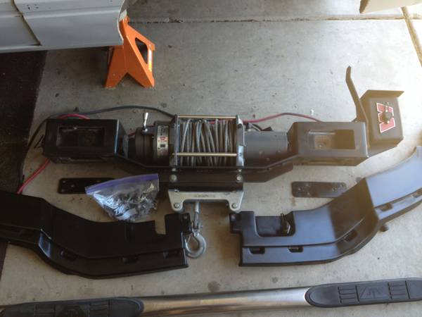

Thanks! I think within the bumper would be ideal but I'm open to anything. Here are some pics to help you guys out.

That's a heck of a winch! If you want to mount within the bumper, you might want to highly consider LOD or the Evo Quarter Pounder. Check with them (or Dave at Northridge) for fitment, but I'm highly confident it will fit.
Hopefully the internals look OK BTW ...
Congrats.
