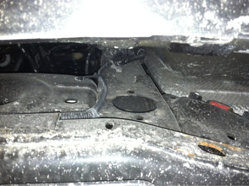

So I got impatient tonight and decided to install my RC 1.25" body lift before my Teraflex 2.5" budget boost arrives. Start the tear down and can't find the 11th and 12th mounts. I keep searching and looking back at the directions, even checked online. Looks like he factory forgot to install the two mounts just above the rear axle. Anyone else missing these two? Did the factory delete these two on 13's?
I can see where they are supposed to be, but nothing there...

I just ordered a body lift for my 2010 2 door and I have the same problem, the kit comes with 10 pucks but I can only find 8. There are two in the same spot as in the picture that are missing. Anybody else have this problem???

Later model JKs are missing two mounts that earlier models had over the wheel wells. The directions just don't show it. This is for two doors and four doors.

Excellent! Just made things easier so that I don't heave to tear anything apart again. Buttoned the whole thing up before going to bed, was hoping I wasn't going to have to tear it apart again...not that it would have been that difficult. Whole process, including finding a suitable base for the floor jack, re-checking instructions, checking on-line and scratching took a little over two hours.
