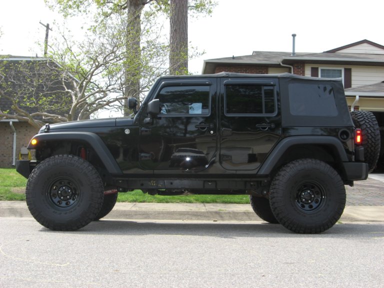

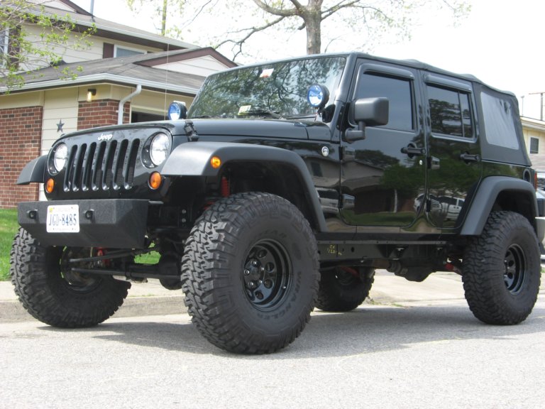

15s will fit, but i have the soft 8s had to put a 1/4 inch spacer to clear the caliper face, if you go with the rock crawler d hole wheels that look like the street lock but with out the lock...no worries. i am runnint 37 12.5x15s on 15x8 wheel...
