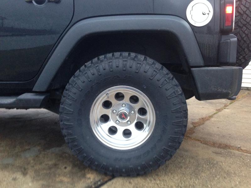

Level 8 Trackers bolt right up.
No adjustments.
Discount Tire Direct

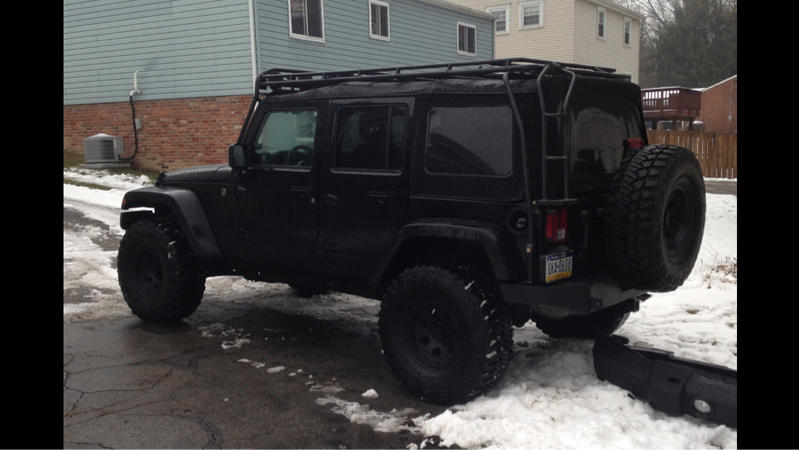

MB Razors went from my 07 to my 15 with no issues either time.
