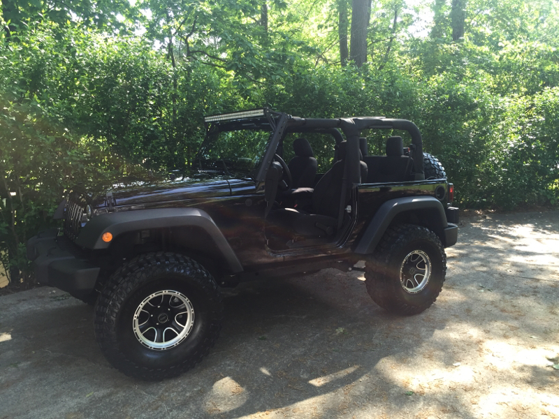

I'm running 15x9 American racing with 35x12.50 Cooper STT pro. I'm using stick on weights now, but may go to balancing beads in the near future.
