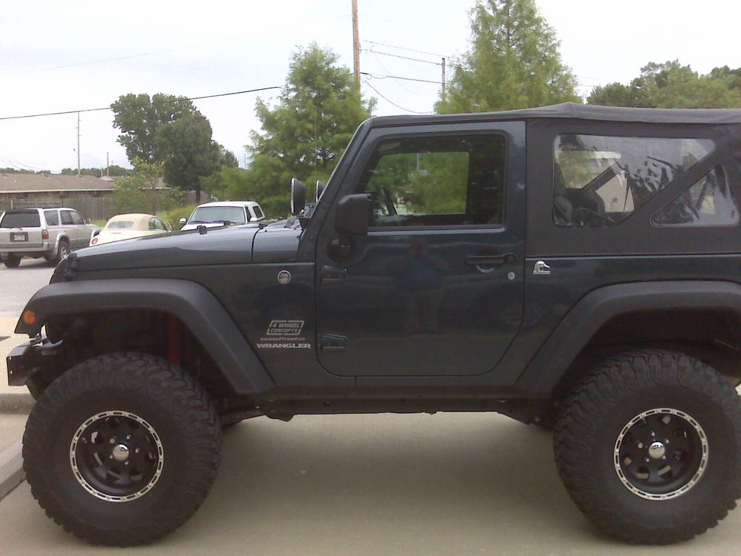

Mine too. Same back spacing as above, 3.75 on 15x8. Mine worked fine. I ordered Pacer Street Locks first and they wouldn't clear the breaks. I called Sam's Off Road in Tulsa and they recommended a wheel that worked out great. They are American Eagle 15x8's. Not sure what the series number is. See pic.
