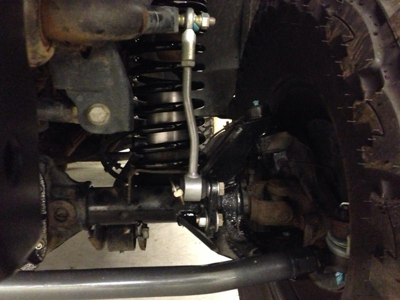

Heard it can be tight. I went with a synergy hd tie rod today and was worried about it fitting my 16's. Lots of room and i could probably do a 15'.

I was running 15's with 3.75" back spacing and am currently running the ruff stuff tie rod with 17's. I can tell you there is no way it would fit behind 15's unless you had about 1" backspacing. People have been having luck fitting the synergy rod ends though

Yup, I run a Synergy TR with 15s. I know it doesn't really help your situation though.
