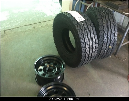

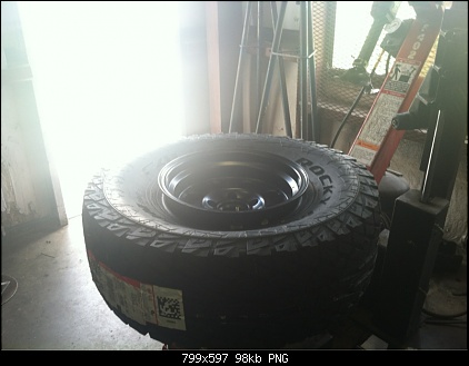

Hi guys! I've been reading posts here for quite some time now, it helped me come to the conclusion of buying my 2012 JKU Sport 6sp! I've been a long time jeep lover, and finally have one that shines
To get started, I ordered a 2.5" RC Spring lift with shocks, as well as Crager soft 8 15x8 with 4.00 BS in order to use my existing 35x12.5 KM2's (which are practically still new).
As many people have experienced, I have slight rubbing when mock mounting the rims in the front. The caliper JUST rubs on the WMS of the rims. I've looked into this and everyone seems to have mixed feelings on what to do. Should I grind them back just a bit? Or use the dreaded "sandwich" 1/4" spacers? Just trying to gauge what people think!
Thanks for your help
