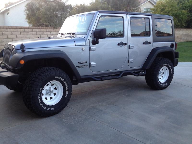

Procomp 15x8 with 3 3/4" backspace with centers off the stock 16" sport center caps wrapped in 35x12.5x15 BFG Km2's. Yes I grownd the calipers but, not much.

I like the 15's my self, still debating if I want to go that route.. tire rack will list which one's fit (well, the one's they sell), as long as you do the wheel finder with your Jeep's info. This said, I've been told many a time that the 17 inchers are the new 15's.
This isn't my rig , but I do love the retro white wagon wheel look. Plus it gives me an idea of what mine would look like (same color).
