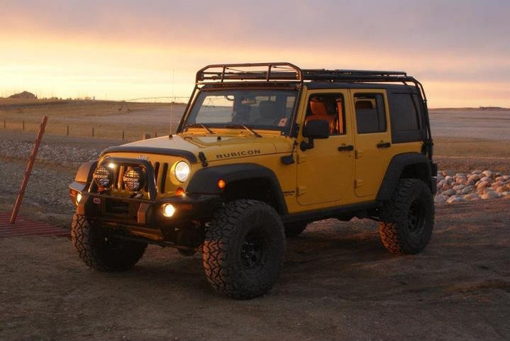

I'm a kid and was new to wheeling. I broke a lot of things finding out what I needed to do to properly wheel and spent lots of money fixing the things I broke. If you are lifting your jeep and I would say save up get the proper tyres, wheels, cv joints, drive shafts, the whole lot. Find out what you need for the wheeling your doing cuz I spent to much on things I didn't know. And you said you research and have experience with your TJ so I have no doubts u will be successful. Good luck and here is my now working JK with my AEV lift and I love it!

thanks for the quick reply!! your jeep looks awesome and im glad to hear you like the kit ! i actually mostly will be doing on road driving as this is my daily driver but i do like to go offroading on the weekends and we go on an offroad trip every year. which is why i choose this kit because of its on road preformance as well as offroad.
