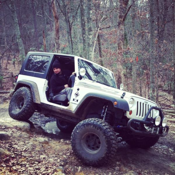

I have run 35x15x12.5 on 15x8 MB72s with no problems for over a year. Everything clears and performs great when aired down.
