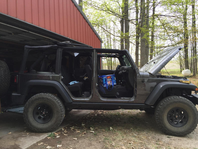

Old May 15, 2015 | 04:02 PM
jeepmojo's Avatar
Posts: 2,318
Likes: 12
From: New Hampshire
Default nope i run
16s works fineClick image for larger version

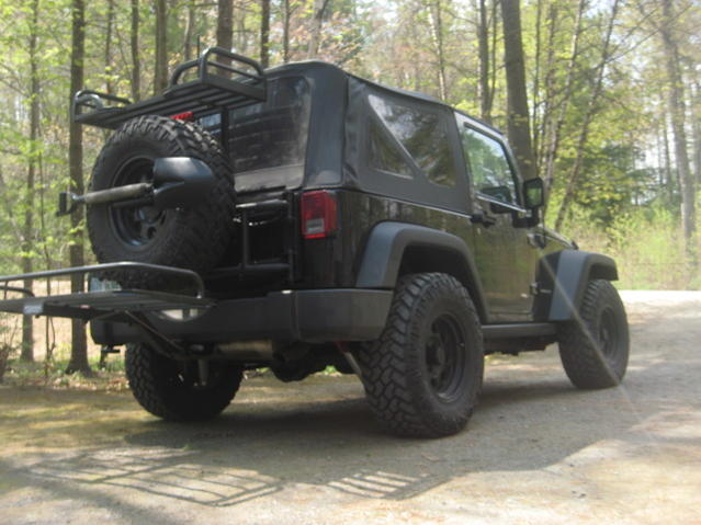

Old May 15, 2015 | 05:08 PM
cedarraider's Avatar
Joined: Jun 2014
Posts: 432
Likes: 9
From: Traverse city MI
315/75/16. No issues I think there is close to a half inch between the wheel and the caliper.
