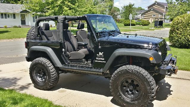

I have 35" mtrk's on 15x8 MB Razors and I have no complaints so far. I was previously running 33x12.50x17's dick cepek FC-II's on 17x9's and the handling loss of the 15's is minimal at best.
