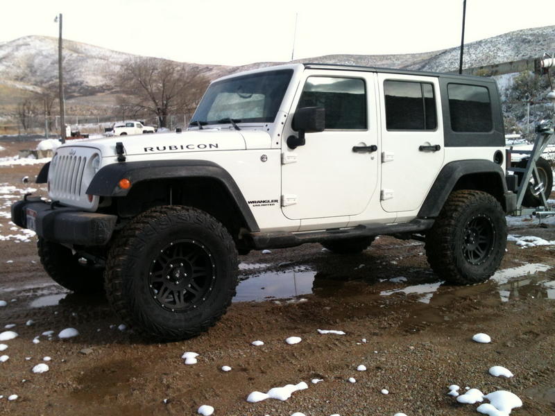

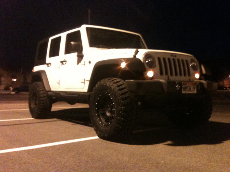

Originally Posted by GearWhore
I installed the same wheel last month. I went with the 17x9 and am running 35" MTR. REALLY like the matte look on my Jeep! Wheels were hard to find when I ordered them (on backorder from just about everyone, but managed to find 5 on the east coast). With the 35s I had to remove my plastic airdam to prevent rubbing, but with TF 3" lift I can turn to full-lock in both directions without any rub.
Attachment 247277Attachment 247278
NICE rig for sure!
