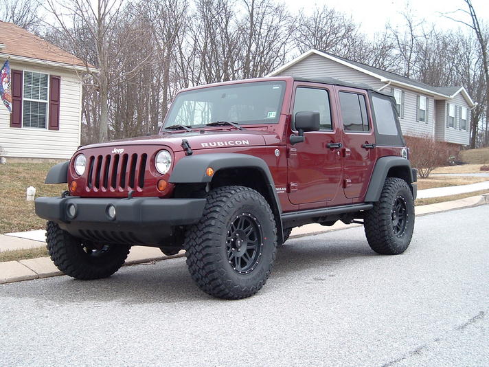

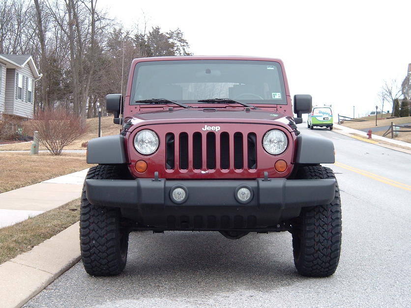

These are 17x8 Pro Comp 7005 w/ 4.5" backspacing and 35's on 2.5 Rough Country coils. These work, but I think I am installing 3/4" spacers next. 3" should be fine.
ID:	20520   Click image for larger version
Nice rig. Love the Mopar enhanced rock rails.
