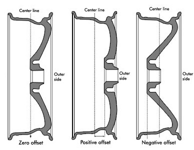

I just had this discussion with dirtman yesterday. 0 offset on a 9" rim should be 4.5" of backspacing. So a -12 offset should be 4" of backspacing. I have checked online calculators and they do report 0 offset as 5" of backspacing on a 9" rim. Not sure why.
Link to thread and a pic:
https://www.jk-forum.com/forums/jk-w...7/#post3992096

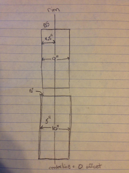

Sometimes a picture...
From what I gather that is the case, the lip width is standard 1/2 inch

Originally Posted by 14Sport
Edit: Just realized, even though the centerline would be the same the offset would be .5" different. I really trust dirtman. So I'm sticking with his assessment.
Yeah I am not one of those people that needs to be right. My disclaimer in my post mentioned I am no wheel expert. If someone knows the answer and you trust them, go with it. I only know what I learned and have seen consistently.

Yeah I understand that....which is what my edit said above. But that is working on the assumption that rim widths are measured from the bead edge and not the flange. I just don't know if that's true. If that is true then that would explain it.
Edit: Even in the diagram I posted it shows two different lines on each edge. Unfortunately, there is no explanation for that on the site that I pulled it from.
Edit again: You can see in post 7 of the link I posted that I wondered if it was the flange but I could not confirm that anywhere.
