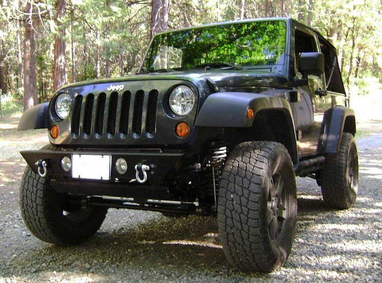

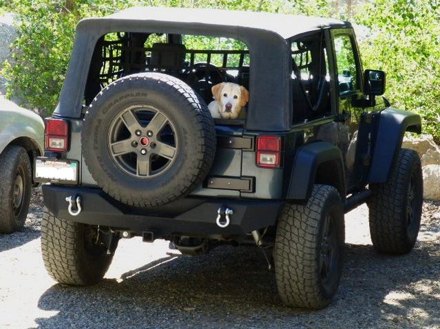

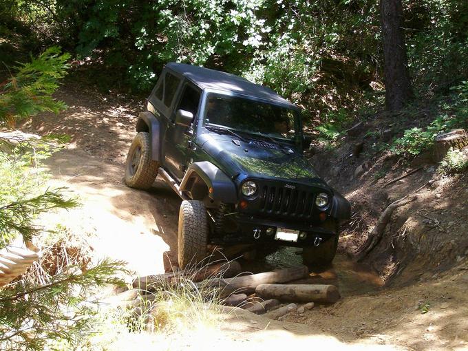

I started out with a 2.5" lift that was easy to use, very little extra mods needed. I moved up to 3", needed adj front track bar, front longer lower control arms to adj pinion, and shorter rear lower control arms to assist the pinion angle. Personally I'm very happy with 3", a bit more involved though than 2.5. I'm running 295/70/17's on OE Grand Cherokee wheels with 1.75" spacers.
