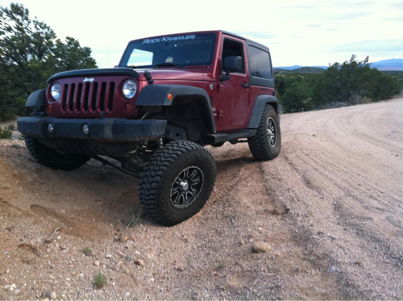

I am running the 2.5 RK lift with 35s, at full stuff I'm rubbing a bit so I'll be trimming my fenders soon. I'm also rubbing the stock front bumper so ill be running a stubby front when I finish with the sawzall.
