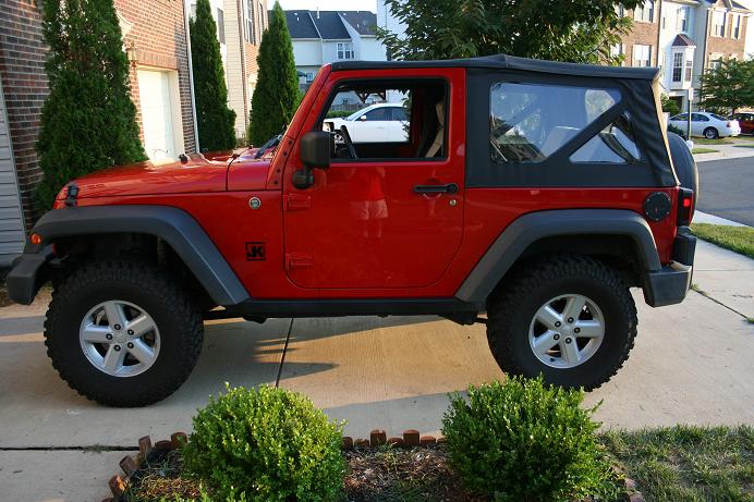

Another Rough Country customer, this time a 2-door. Running 285/75/16 on stock wheels with the 2.5" Coil and Shock lift, absolutely no rubbing or issues. Also ask for the 10% JK-Forum discount, that took care of the shipping cost for me.
ID:	30310   Click image for larger version
