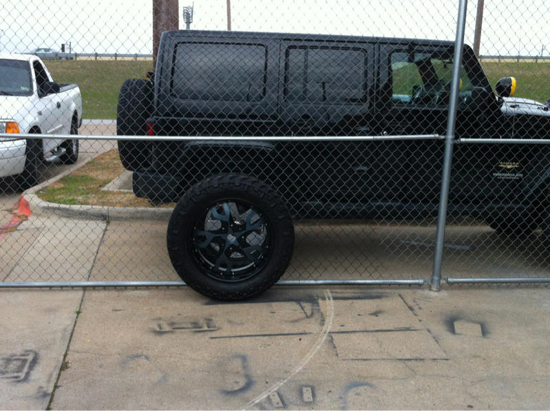

That's odd. I have a 4" RC lift and have no issues what so ever. I think it's a little top heavy feeling since I still have stock rims and tires (waiting on custom Forgiatos and Trail Grappers). But other than going up 4 and not going out 3 with less offset or spacers, I think the ride is pretty damn good for an otherwise cheap lift.
