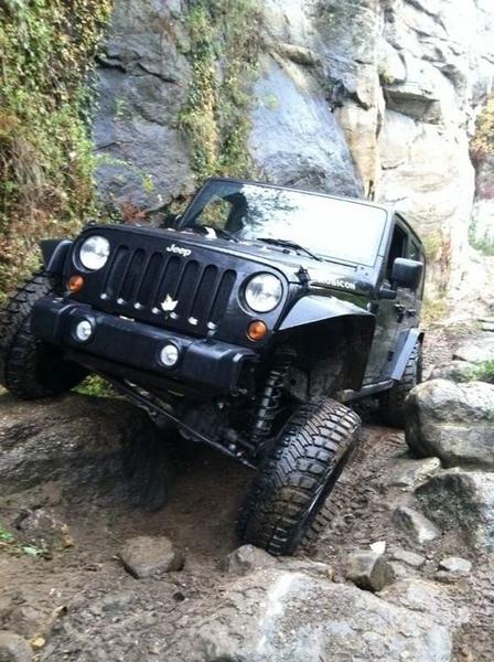

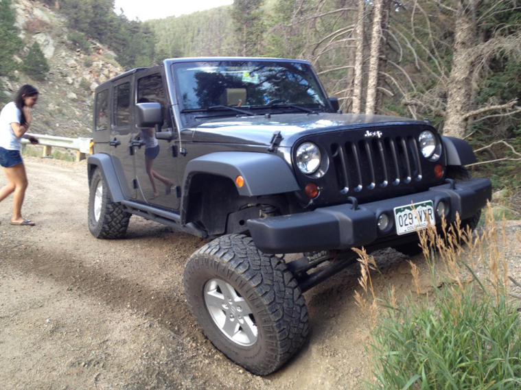

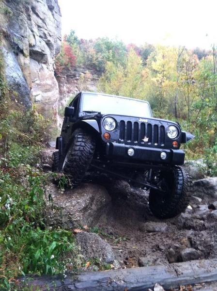

RK 2.5 and 35s. Make the decision yourself...
Awesome flex! You're just using the RK kit, no other changes?

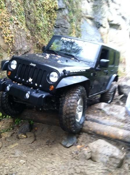

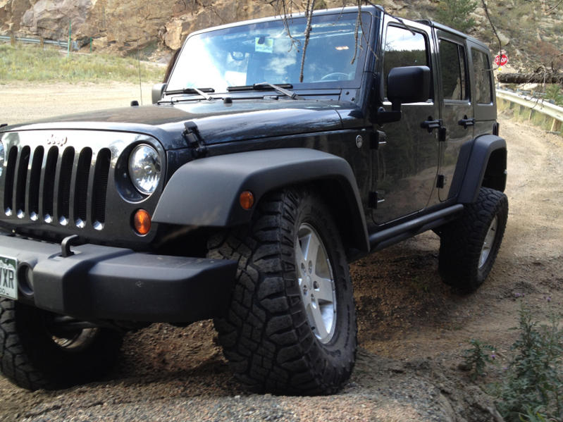

Do it 35s look small now. I would be upset with 33s

Sleeved and gusseted, RK Flex w/ Bilstein 5100s and 2" bump stops. On road ride is great. For the money I could not be happier with how it performs Offroad.
