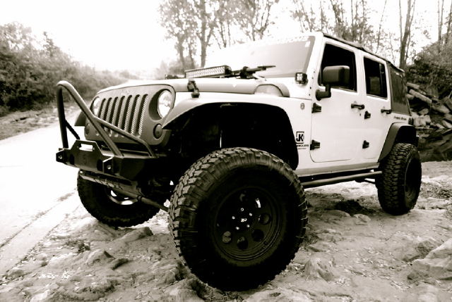

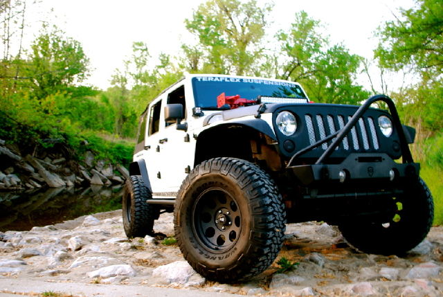

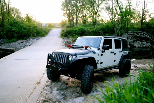

You said you already have a driveshaft and thats the major problem... I have a 2.5 teraflex with a 1 inch teraflex coil spacer in the front. I also have a 1 inch bodylift. My only problem ive experienced is my driveshaft is going bad but you wont have that problem if you already replaced it with aftermarket. Here is a picture...

How is you driveshaft going bad? Do you have it Aligned at all?
having the stock driveshaft with 3.5 in the front is leaving it at a bad angle so its spitting grease.
