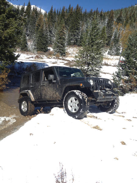

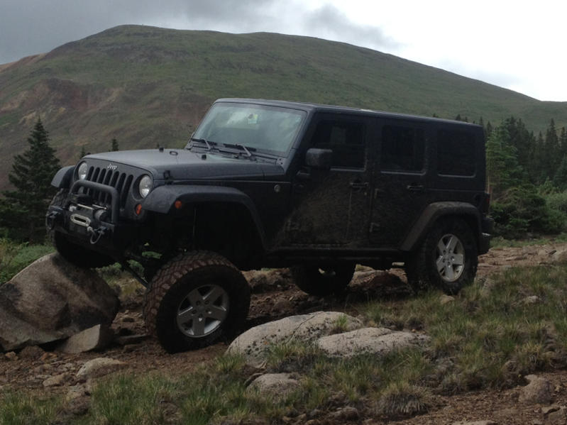

Old Oct 10, 2013 | 06:45 PM
ski-YA-later's Avatar
Posts: 310
From: JunkTown CO
Teraflex 2.5
Teraflex s/t swaybar
1.5 spidertrax spacers
315/17 duratracs. No rubbing.
Trimmed pinch seam.
Doorless pic same set ups with stock tires.

Old Oct 10, 2013 | 07:17 PM
Turbo's Avatar
Posts: 227
From: N.E. California
I agree with the 1.5" Spydertrax spacers. I have the Tereflex 2.5" lift and the spacers and all is great after 3 years.
