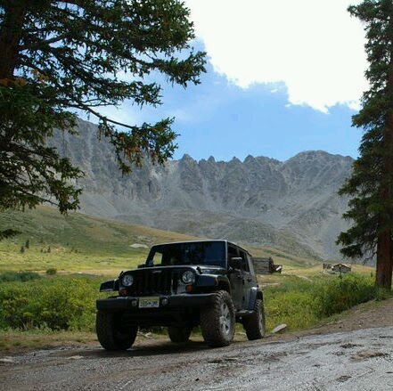

So here's a couple of pictures. I've put all mods on hold as we're expecting our second kid and I'm stuck between making it work for a family or selling and going another route. Should I keep it, this spring will be more mods to "dial it in".. if you have any specific questions, let me know...
3.5" of lift
