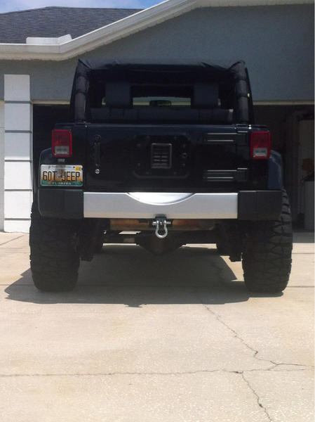

I'm running the teraflex bb with shock extensions and 35's.....no issues here.

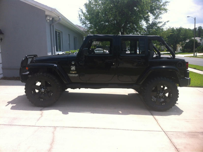

Same here teraflex bb 2.5" with extensions

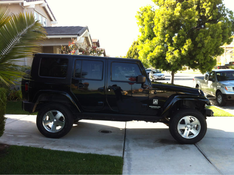

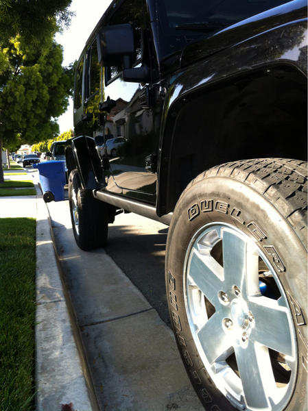

I just added the 2.5 no shocks with 1.5" spacers

As far as ride quality goes: there isn't supposed to be any difference. Some will say the difference is that extensions will somehow limit your off roading capabilities. I don't know how true that is.
I went with the no shocks kits because I wanted the Bilstien 5100 shocks. My shocks had over 70k miles on them. And I just went with the Bilstien over the Teraflex because of personal preference.
Spacers are probably a good idea if you're gonna keep your stock tires and rims. They push out your tires and really look a lot better; more like personal preference, I guess. But you'll definitely need them if you're going to run bigger tires on your stock wheels to avoid rubbing. I'm glad I got them as I think my jeep would look funnier without them.
