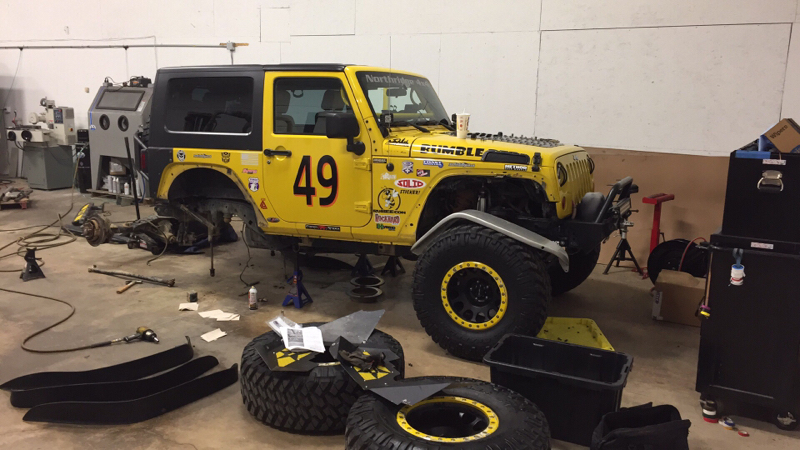

Started my RK 3" yesterday with disassembly.
Northridge 4x4
Old Dec 11, 2016 | 04:31 AM
Wrangeler X's Avatar
Posts: 659
From: Channahon IL
And I learned that I'll have to modify my LOD bolt on sliders because the lower long arm mounts interfere.
Northridge 4x4
