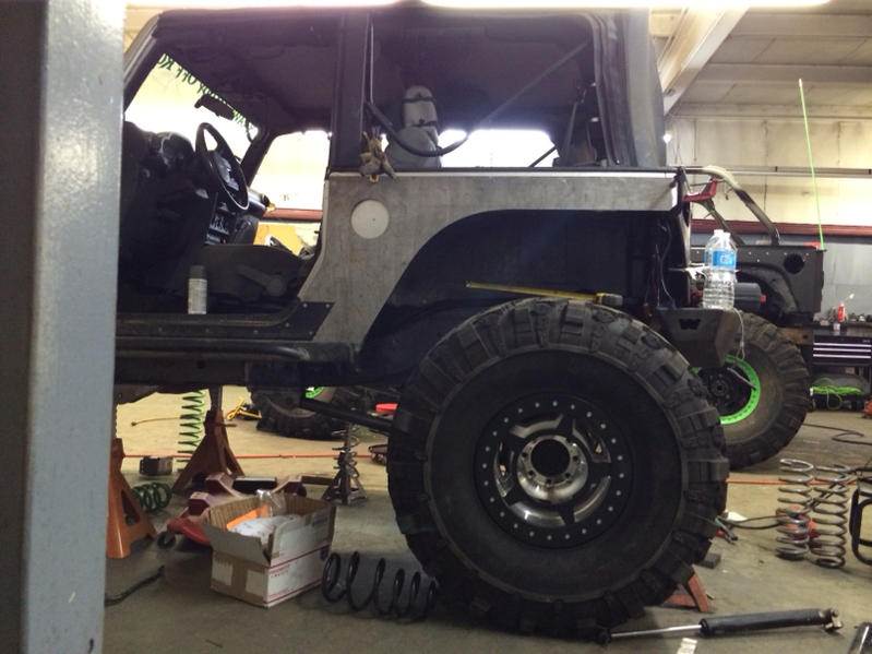

Working on a 12" rear stretch now.
Nice!! can I get some pics of the coil and shocks locations?

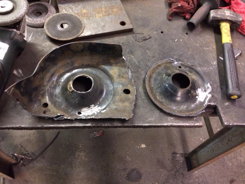

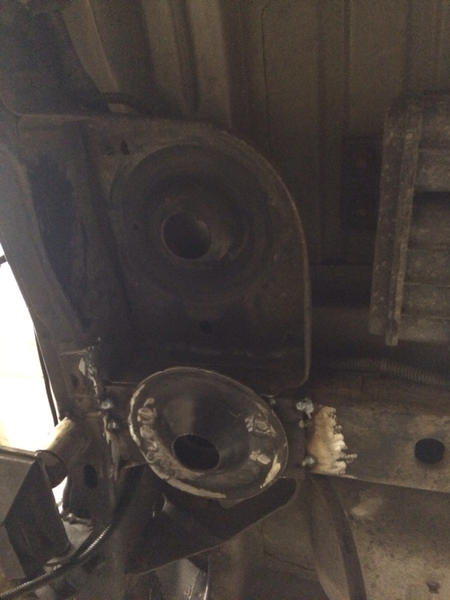

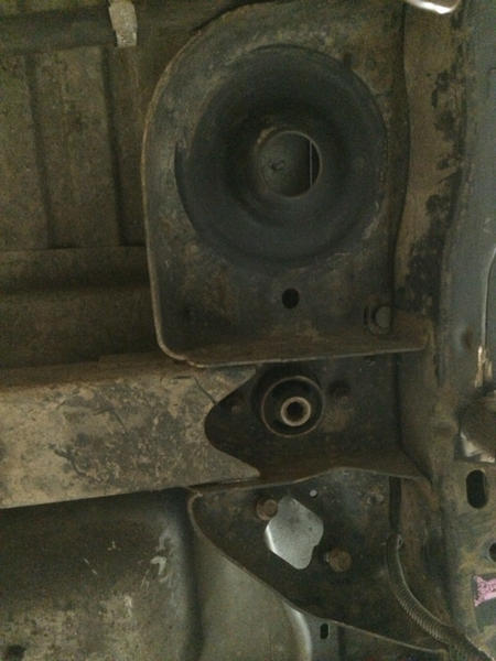

Thanks.
Relocated stock spring upper buckets

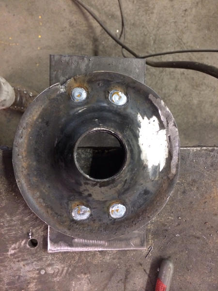

When I started my stretch I just reused my buddy's old coil mounts and plug welded them to a plate with a hole drilled in it and mounted them over the body mounts. I'm going with outboard coilovers though so not using this setup anymore. Was a decent idea though...
Thanks it look awesome!! But do you think I better wait to do it with coilover the first time ?
