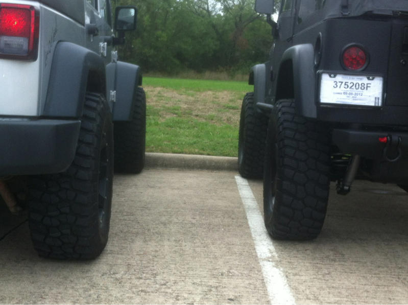

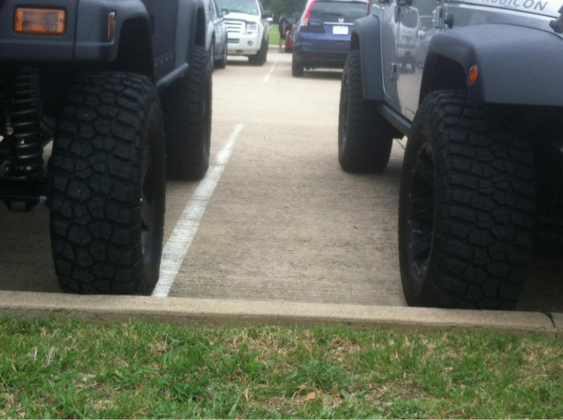

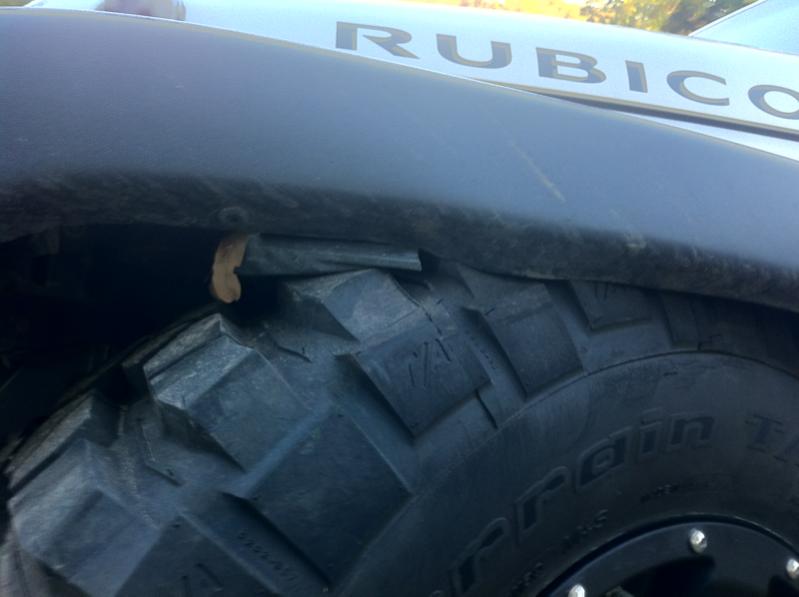

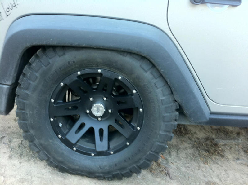

If you go with only a 2" lift and do not extend your bump stops or trim the fenders, you will rub disconnected with anything more than a 33" tire. These are a wide 33" tire (about 32.5"x12") that rub.
Guy beside me had the 285/70R17 BFGs. Note mine are basically the same height, but wider. Note how the 305 width has much large tread blocks and larger voids. = better off-road in most cases.

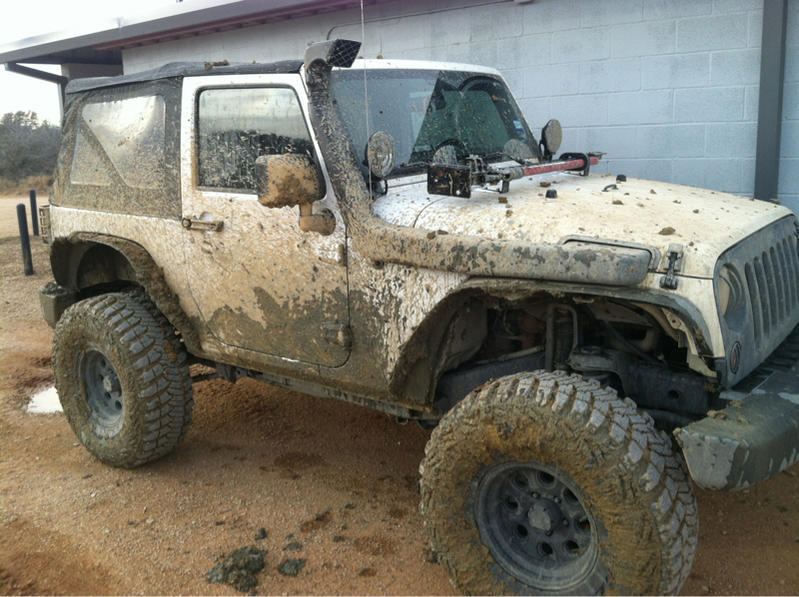

Only picture I had at the moment. but this is a jks jspec 2in coil lift with 35in mtrs and flats.

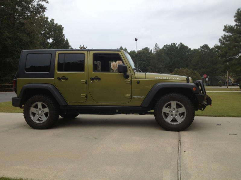

I have Rusty's 2" on the front of mine. I purchased the 2" coils from Rusty's in order to compensate for a heavy bumper and winch that caused a 3/4" additional sag on the factory rake. I netted 1 7/8" over stock and that is with the ARB Deluxe bumper and a 12k winch on the front. Not light by any means. The ride is as good or better than factory. I put them on my 2010 JKUR with 22k miles about 2 months ago and just put them on my 2013 JKUR with 20 miles and they ride great. No complaints. The only caution I will throw out there is that you will gain well more than 2" if you don't have an aftermarket bumper and or winch.

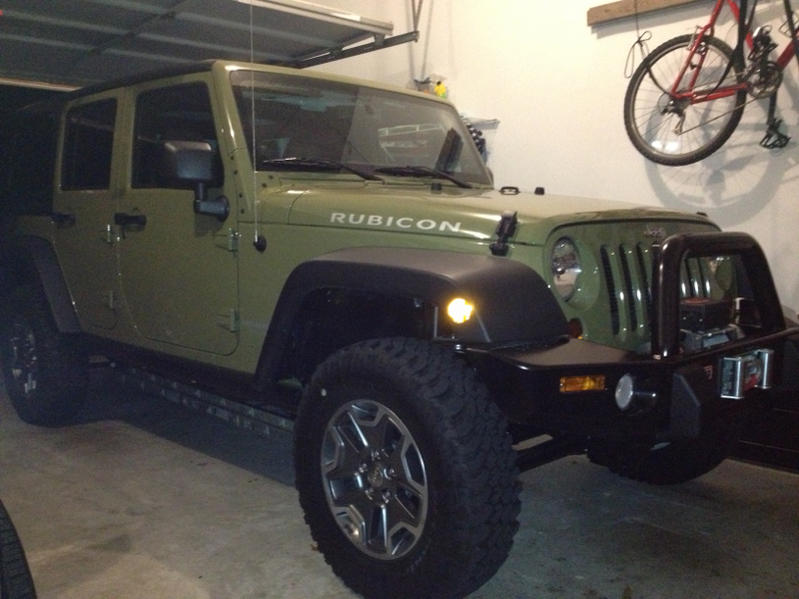

Above pics were of my 2010 I don't have any of my 13 outside but snapped one of it in the garage.
