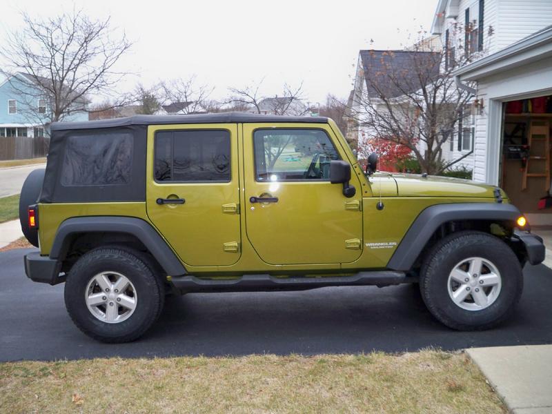

I agree with WOL. If your goal is just to fit 33's you are pretty much fine doing so with a stock set-up. This is mine when I got my 33's prior to upgrading to Procomp wheels. You might consider a Rubi spring/shock upgrade. I gained a little doing that prior to just lifting it.
